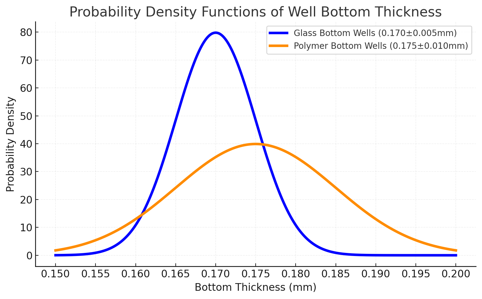

Quickly modelled out:
Simple analysis:
  • Cohen’s d = 0.63
    → This indicates a moderate to large effect size, meaning the difference between the means is meaningful relative to the spread.
  • Overlap Coefficient (OVL) ≈ 0.61
    → About 61% of the two distributions overlap, suggesting there is considerable but not complete similarity.
  • Kolmogorov–Smirnov (K-S) test
    KS statistic = 0.376, p-value ≈ 2.5e-63
    → This is a highly significant result, indicating that the two distributions are statistically different.
My suggestion
There is a difference between the manufacturer-declared material_z_thickness (i.e. the bottom of the wells that light has to pass through).
But it doesn’t seem like any imaging device would realistically be affected by it.
I therefore believe a single definition with variant information in its metadata should be sufficient.
