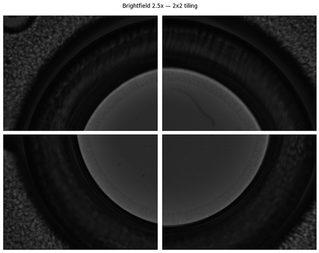

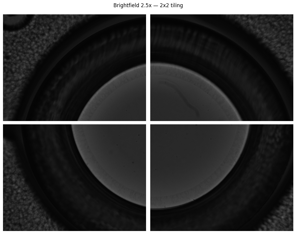

num_rows, num_cols = 2, 2
result = await cytation.microscopy.capture(
    well=(2, 3),
    mode=ImagingMode.BRIGHTFIELD,
    objective=Objective.O_2_5X_FL_Zeiss,
    plate=plate,
    exposure_time=2.0,
    focal_height=3.0,
    gain=5.0,
    backend_params=CytationAravisMicroscopyBackend.CaptureParams(
        led_intensity=5,
        coverage=(num_rows, num_cols),
        center_position=(0, 0),
