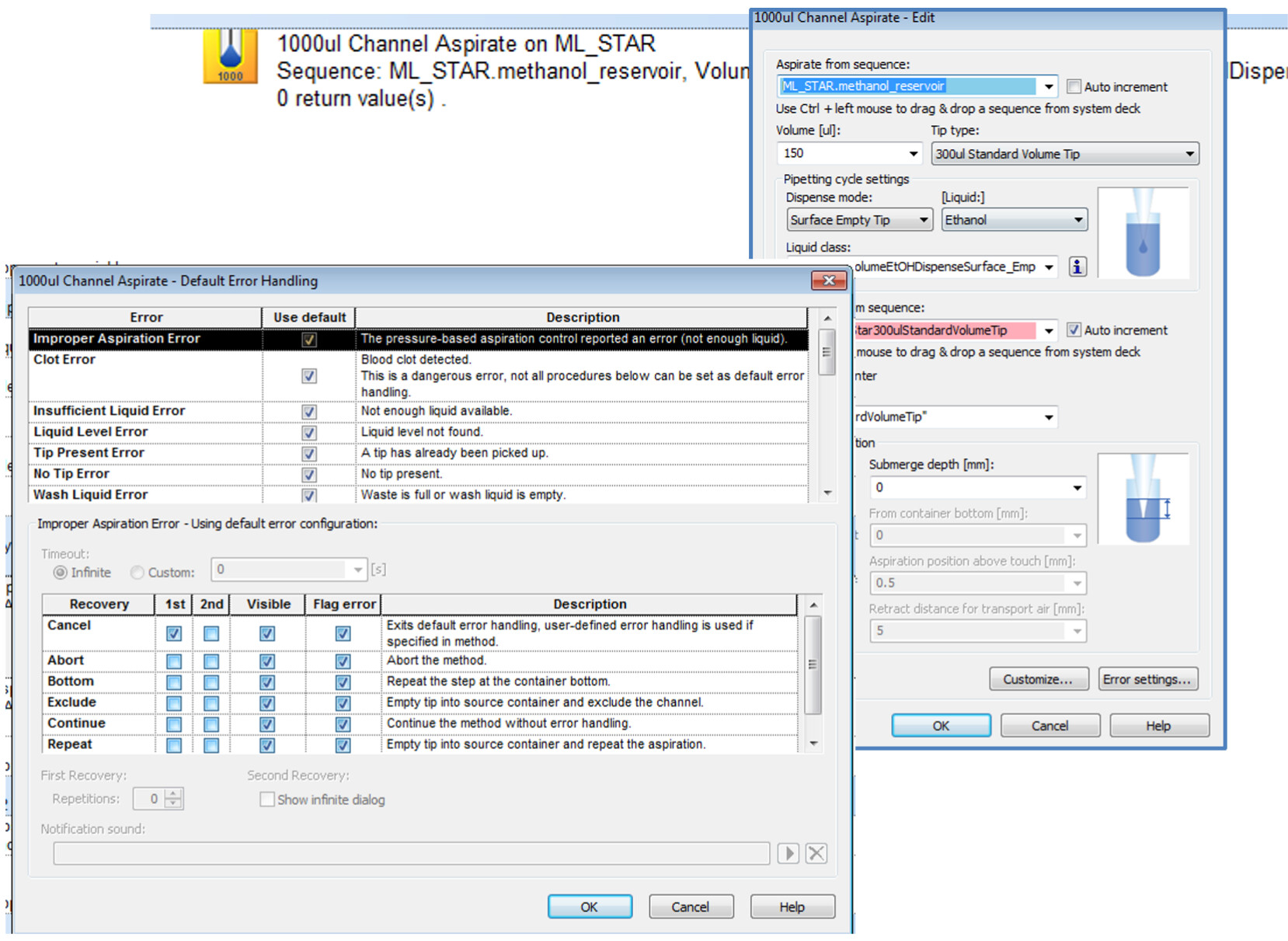

Yes, this is much longer than a simple method call… but the more I am testing this, the more I realise that this is the bare minimum information that is required to achieve proper error handling. Error handling is just intrinsically a complex responsive action.
This is especially important when retry_functions require constraint-combinatorial kwargs modifications:
e.g. if a LLD aspiration fails and one wants to aspirate from the bottom, they have to not only modify the LLD_mode but also have to ensure that there is no Liquid Level Following distance specified when making the switch → otherwise it will crash.
As a result the retry_functions must take their own kwarg arguments to specify the change in the method kwargs we want to see.
The only thing: it isn’t pretty code
But it is explicit, highly adaptive, very readable and incredibly powerful - without modifying the method definition itself or being dependent on any specific machine (at this top / general purpose error handler level).

I wonder how the OEM softwares handle the error/retries?

You can easily check this if you still have a Windows PC and the free VENUS 4.5: open VENUS, generate a basic deck layout and an aspirate command, the error handling options for 1 single command are buried inside the “Error Settings” tab:
→ yes, every command has to be told the specific error and the specific action of how to respond to it… and of course, it is up to you, the automator to keep all the information of all your “tab-buried” error handlers for every command in the entire automated protocol in your mind :smiling_face_with_tear:
(and don’t forget: there is no “Undo button”/Contr+Z, nor is git-based version control possible due to the binary nature of the files)
