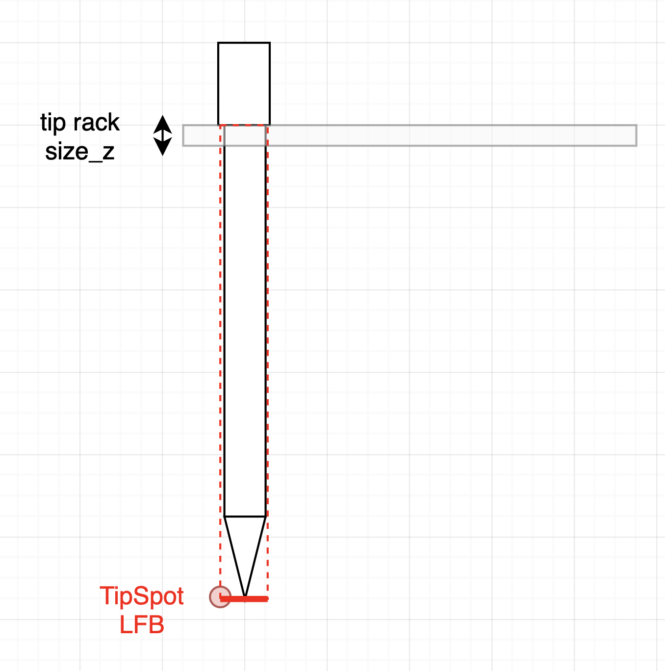

for background: i first wrote tip racks when things were more based on venus (i was just starting out). it has never been refactored since then. in sort of “v2” (refactor) of the resource model, we have been basing things on physical reality rather than whatever OEM software uses (Camillo has really been leading these efforts). this means we can no longer use the definitions (rck, ctr, etc. files) from venus since they actually lack some information (most importantly, material_z_thickness).

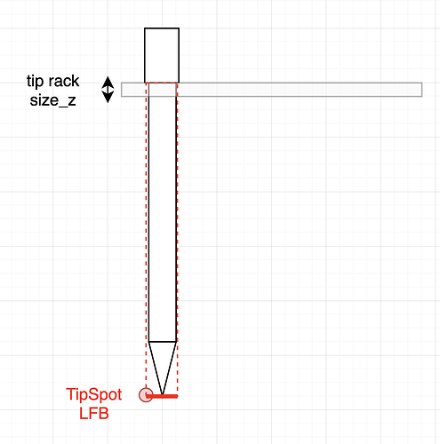

currently, the system should look something like this (we hope to refactor it soon):
the tip spot is defined with a negative z-location, below the tip rack. the tip goes up from there The tip spot actually has size_z of 0, so it really is a flat line. Since each tip has a different height, the z-location (always negative) of the tip spot is actually dependent on the specific type of tip that is stored. Which is obviously gonna cause a problem for the tip adapter which should support multiple tip types. And also it’s a problem for the normal hamilton tip racks, because they are all the same plastic rack so really we should be modeling it as one rack. (so we will change in the future. i am just describing the current venus-based system.)
modelling the adapter as a tip rack sounds like the correct thing to do. but i guess before that we need to fix the tip rack definition so they are independent of the tips they store (obviously?)
