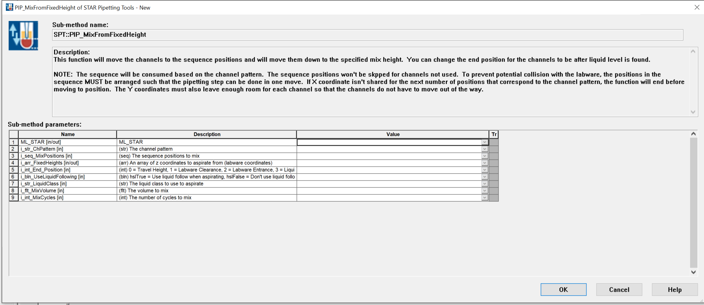

Hamilton has run into this debate before, eventually they made the library tool:
If you want to dispense with CLLD but mix at a fixed height you cannot do this, so this separate tool was built.
Thank you for sharing @cwehrhan - more indications of the utility of such a method :slight_smile:
