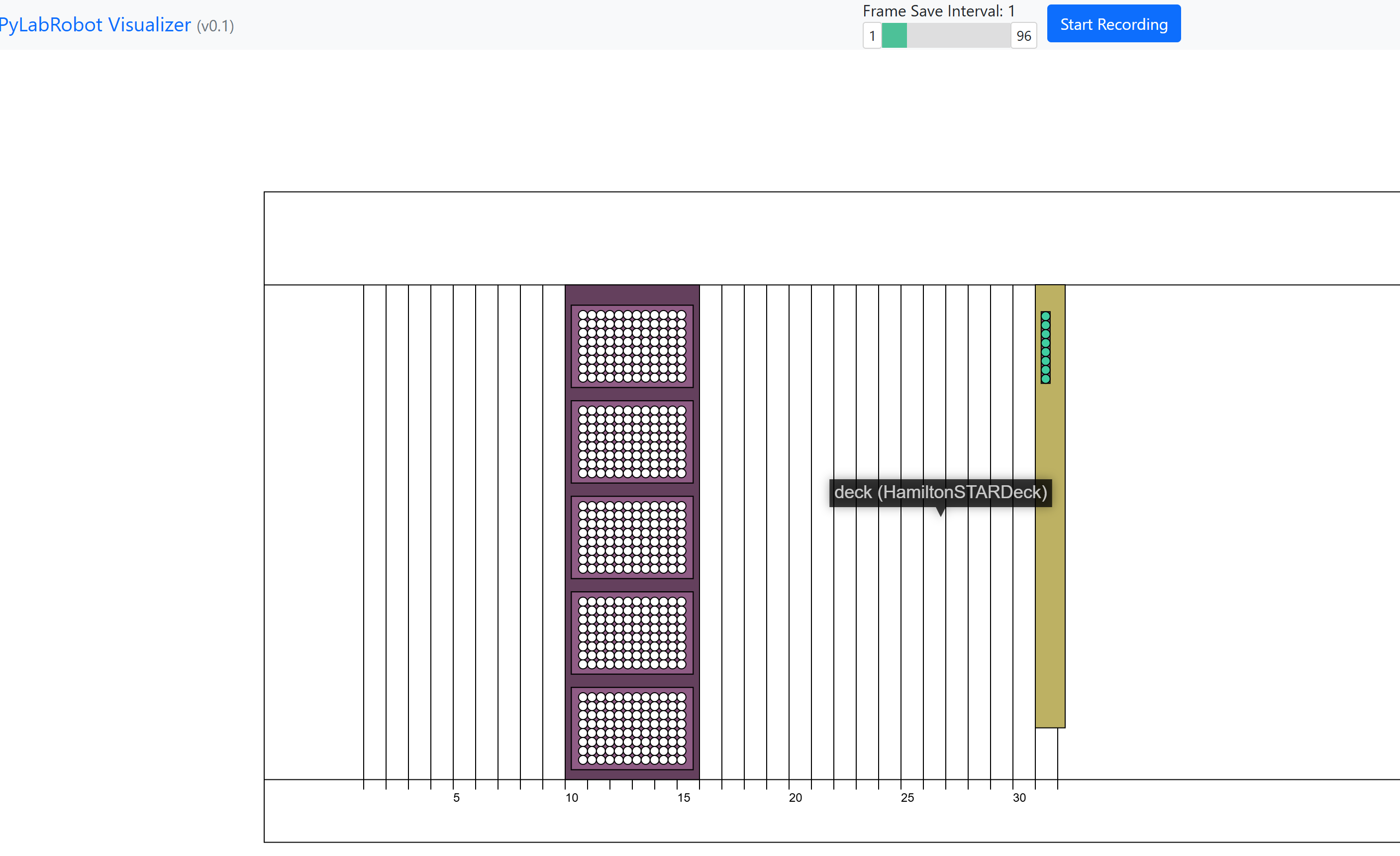

Running a super basic program and not seeing my PLT car populate on the visualizer. I am assigning it as a child resource on the deck:

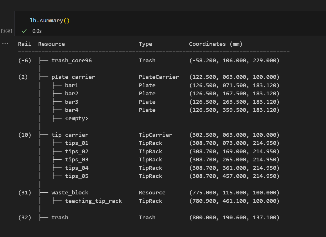

My lh.summary has it assigned too:
Though when looking at my visualizer I am not seeing it!
Anything I’m missing?
is the visualizer connected to the correct port?
I see the tip carrier appear which is sketchy

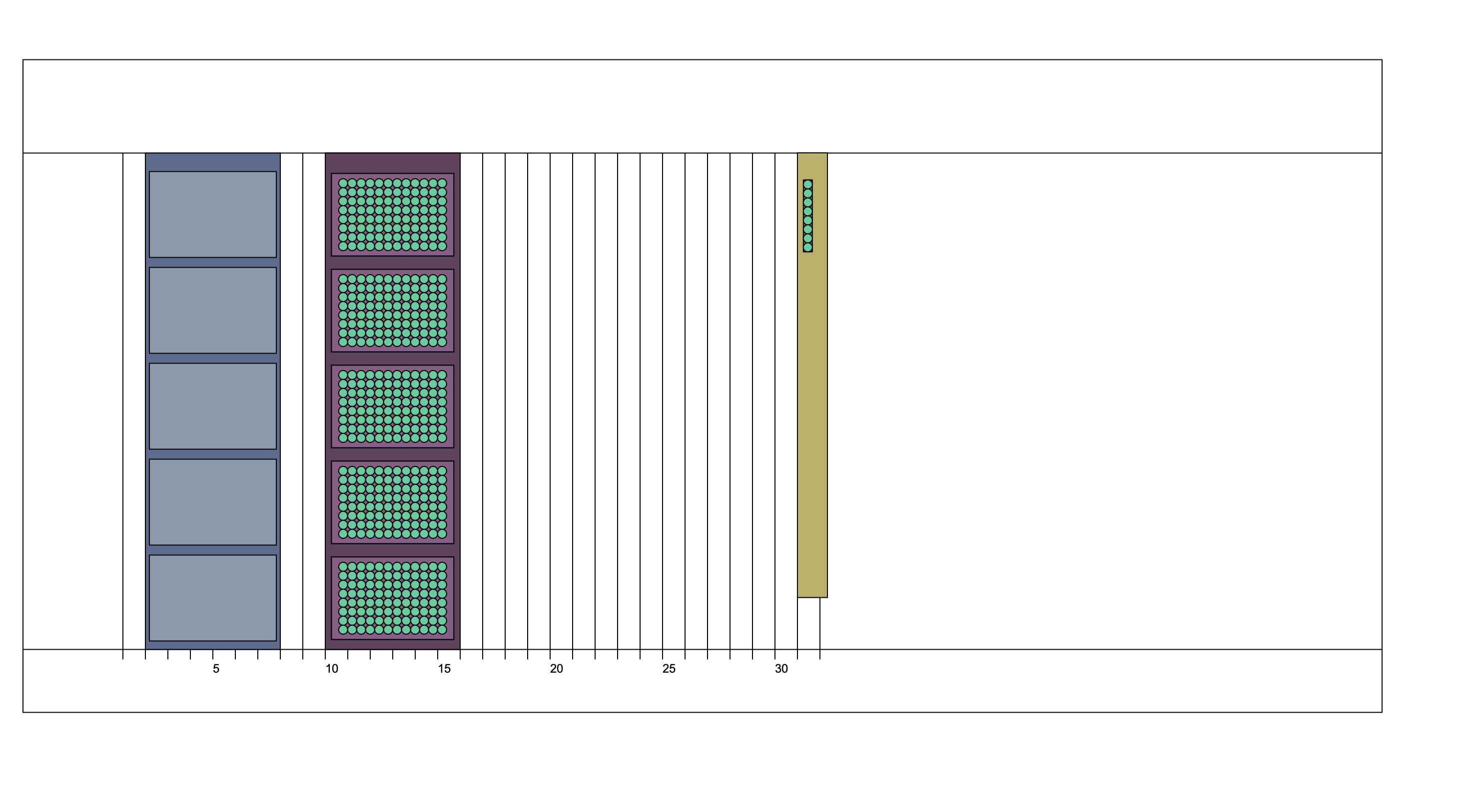

I removed the pandas and qt since I don’t have those installed, and the visualizer does work:
here’s the code. just removed stuff from your code that doesn’t run locally for me. hopefully it can be a starting point for you

Word, for sure something on my end, the code you pasted shows the same deck layout as before with only 1 tip carrier. Also moving my tip rack around does not change. I’ll dive into this tomorrow haha

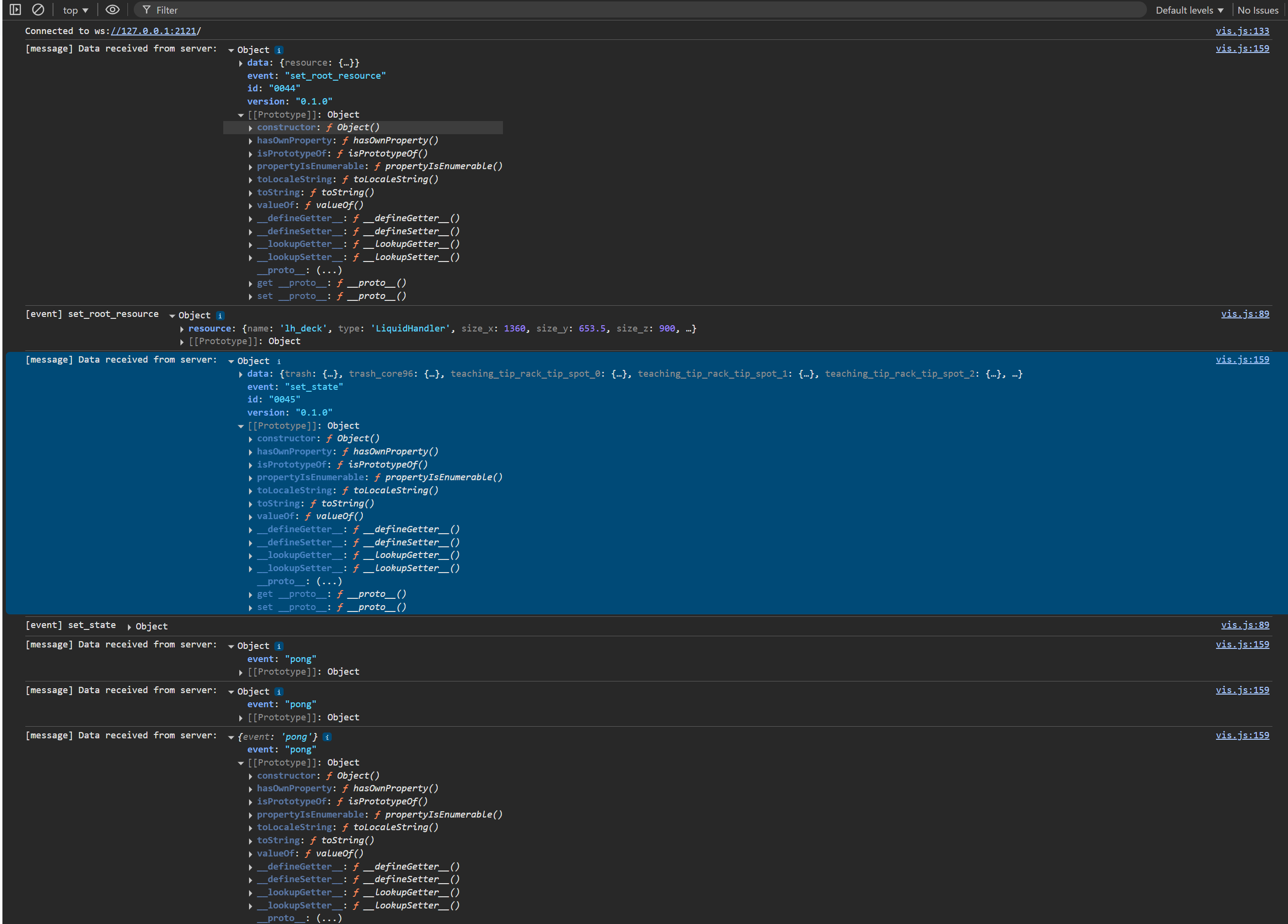

really? that’s weird. could you show the output of the console? are you running the latest version/commit of PLR?
let’s fix the plate carrier issue first, maybe they have the same underlying cause. and I know for sure the plate carrier is working on my machine :trade_mark:
Not seeing the PLT_CAR in the console objects, seeing the tips though

I hadn’t restarted my env after pulling. After closing VScode and opening its working lol
