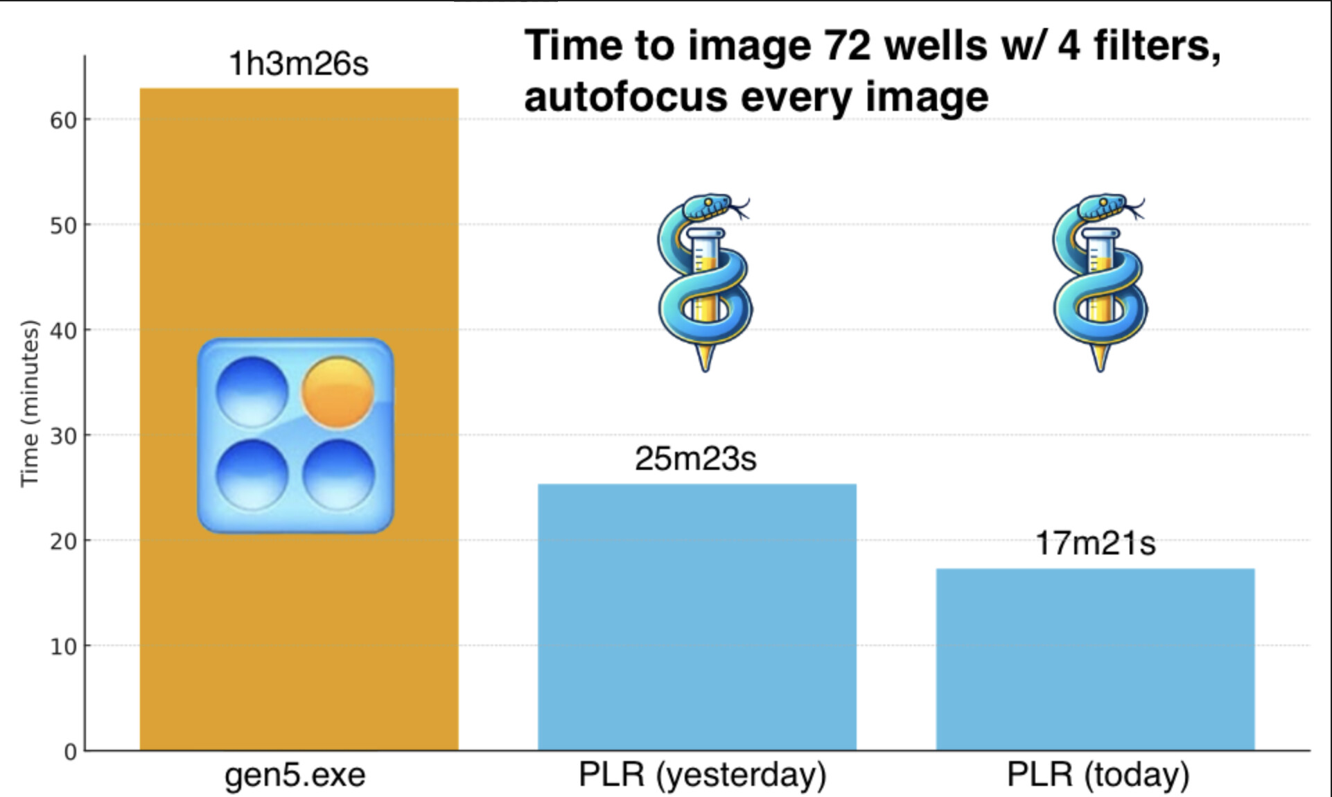

Cytation5: Time to image 72 wells w/ 4 filters in gen5.exe vs PLR

Just to understand more what is going on:
You are taking images (data==array of ints) or your are plate reading (data==single int)?
In both the OEM software and PLR, you are measuring 72 wells out of a 96 wellplate, with 4 different imaging channels.
If imaging, how many fields of views are you capturing per well?
Are your performing an autofocus search on every channel for every channel (for every FOV), or perform one autofocus at the first well and apply that z height to the entire plate?
yes, imaging. 1 field of view per well
autofocus for every (channel, well) tuple (this actually improves results)
