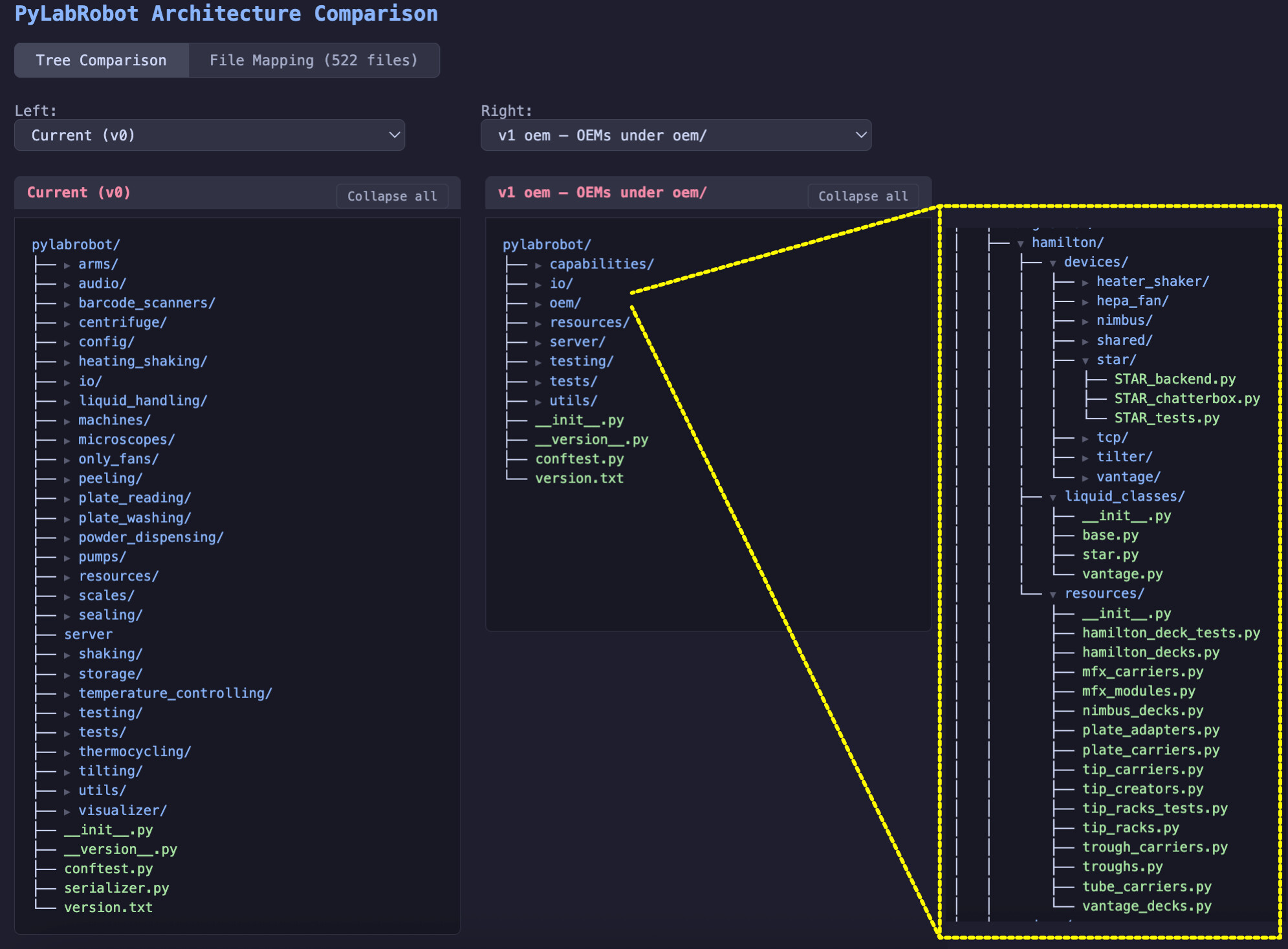

pylabrobot.oem = their labware and devices in one place
I really like this split at the top level.
the alternative, just repeating for clean comparison, is:
pylabrobot.resources
                    .oem1
                    .oem2
                    ontology things like resource.py, plate.py, etc.
pylabrobot.devices
                  .oem1
                  .oem2
                  ontology things like io, capability.py, device.py
if we went that route, probably keep in base level:
  • serializer
  • visualizer
  • config
since these span both devices and resources
Is this the current design? :slight_smile:
no it is not under oem
you can see the current design on the branch:
