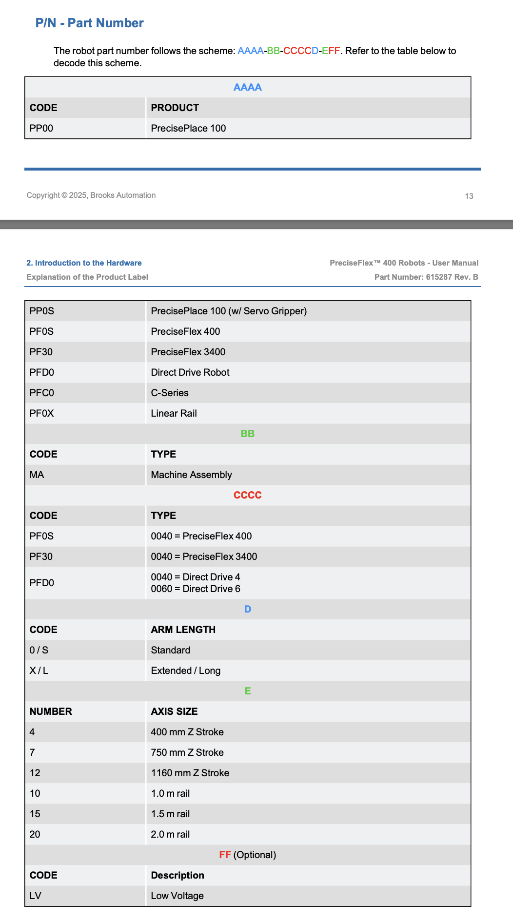

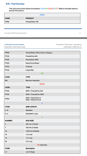

I found this scheme in the user manual, which shows even more options than camillo shared:
our part number (PF00-MA-00400) does not conform to this format however!

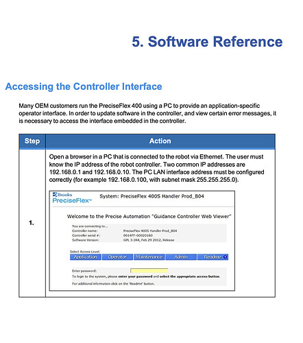

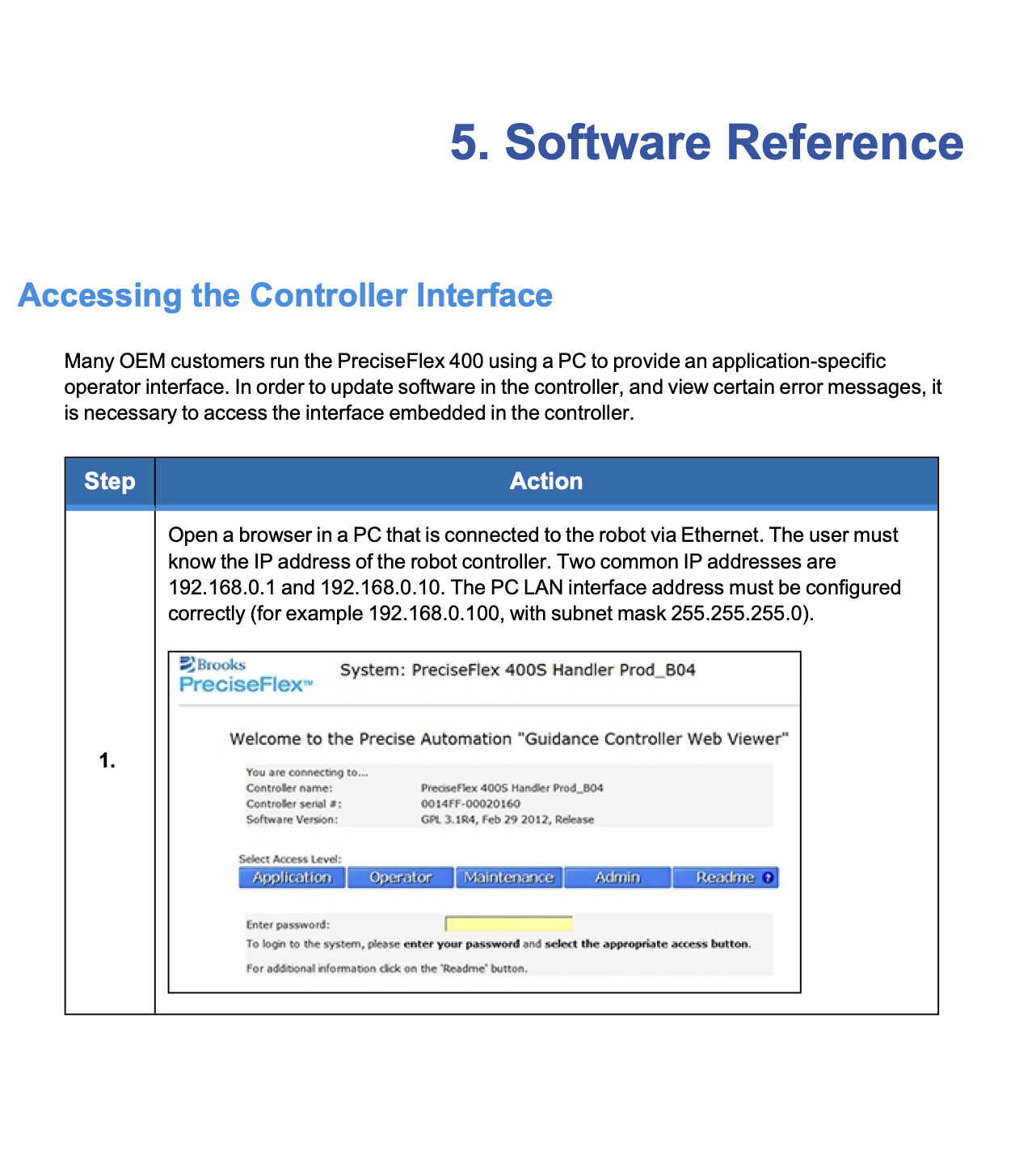

does anyone know if the robot has a self assigned IP? if so, what is it? if no, how to discover it?
where did you find to use port 10100
the user guide says “See the Setup and Operation Quick Start Guide for instructions on setting the IP address for the controller”
what is the ‘Setup and Operation Quick Start Guide’? i can’t find it
answer
user guide says “Open a browser in a PC that is connected to the robot via Ethernet. The user must know the IP address of the robot controller. Two common IP addresses are 192.168.0.1 and 192.168.0.10. The PC LAN interface address must be configured correctly (for example 192.168.0.100, with subnet mask 255.255.255.0).”
192.168.0.1 works for me (for web interface at least)
port 3000 works for me for the api
