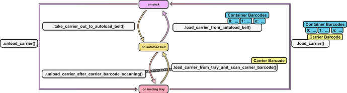

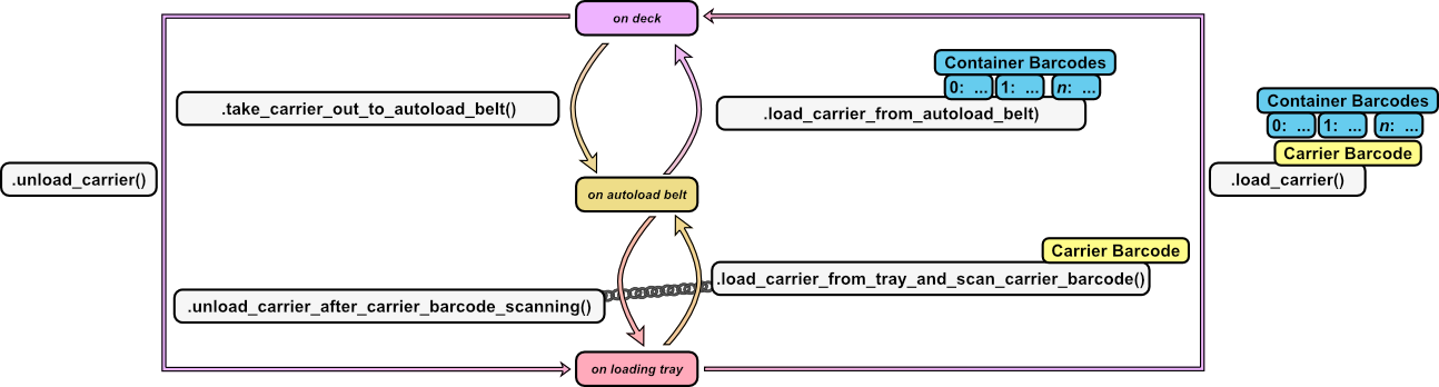

Hi everyone,
The core autoload and the 1D barcode scanning features on a PLR-powered Hamilton STAR have not been updated since:
With one notable exception:
So I upgraded it now:
Key Changes:
  • Created detailed Jupyter notebook tutorial in the docs with examples and architecture diagrams
  • Renamed and deprecated autoload methods for consistency (e.g., initialize_autoload, move_autoload_to_track)
  • Added comprehensive carrier presence detection methods for both loading tray and deck
  • Introduced granular barcode reading methods: IF a barcode has been detected a Barcode class will be returned for both (1) carrier barcodes and (2) container barcodes.

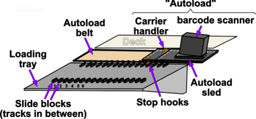

Created master infographics for alignment on machine and command nomenclature:
There will be more autoload and barcode reading commands along the way; I’m quite excited to get the 2D barcode reader fully integrated into PLR :slight_smile:
Happy automation :mechanical_arm:

We’ve got a simple Cognex DM260. There is indeed a Hamilton metal bracket to “piggy-back” onto the autoload 1D barcode scanner. However, (1) our service team told me this is no “official” way of doing it, and (2) I have encountered some hardware issues with it:
It places the Cognex into a suboptimal position in which its communication/power cables have to be cable-tied to the autoload sled, and depending on how one does that the Cognex still scratches the autoload’s 1D barcode scanner during 1D barcode scanner rotation.
This hinders the 1D barcode scanner from fully rotation and can lead to 1D barcode scanning errors.
I’m designing my own adapter at the moment to overcome this little issue, happy to share once we’ve got something nice :slight_smile:
