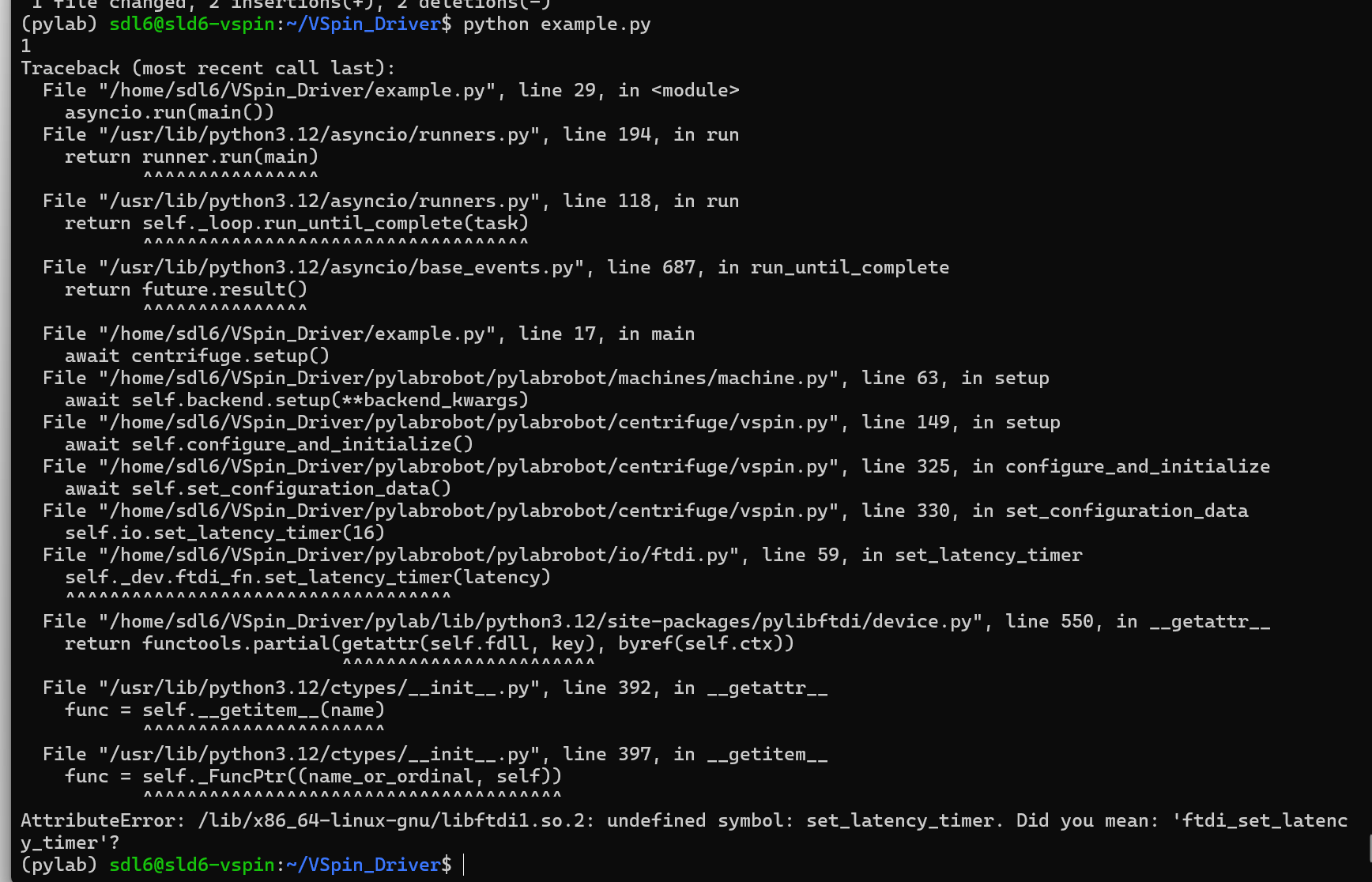

Error when using centrifuge on linux
I am getting this error when running a script on linux. The same scripts works fine on macos.
Any help would be greatly appreciated.
fixed with fix io.ftdi by rickwierenga · Pull Request #409 · PyLabRobot/pylabrobot · GitHub, please pull
accidentally edited above post instead of reply but anyway it’s fixed, just git pull
thank you!!!
