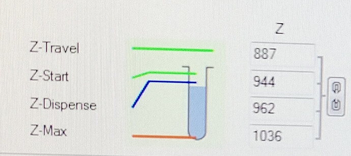

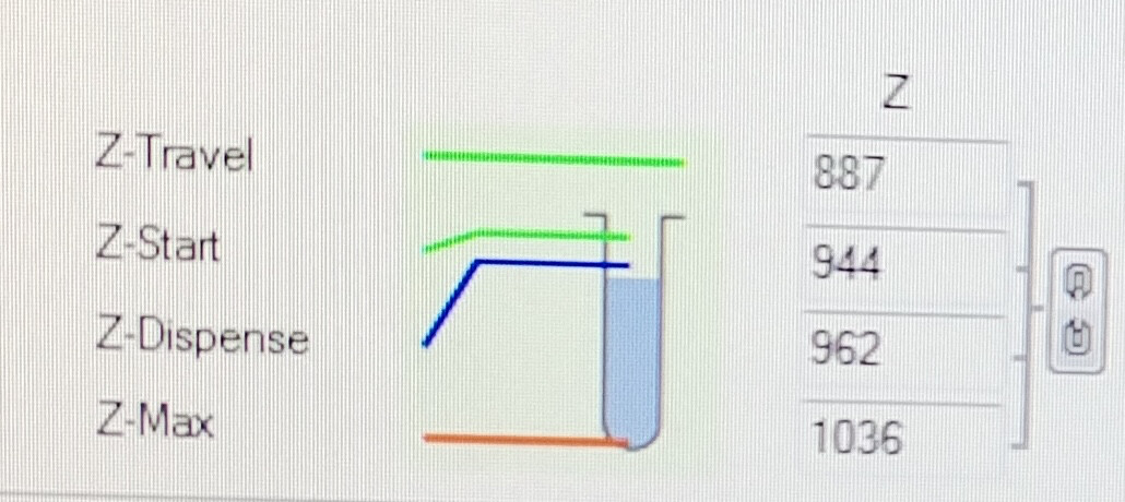

z_travel is kind of a mysterious attribute.
screenshot from evoware:
i think it’s like “traversal height” in hamiltons: the minimum height the channels and other components need to be when moving over this resource. if that’s the case, we can just set a global z_travel height that’s used for everything (like the hamiltons) instead of this. but i could be wrong about what z_travel actually is.
in any case, this attribute is not used right now so I think it should be possible to actually remove it from TecanResource. @VilhelmKM could you weigh in here?
