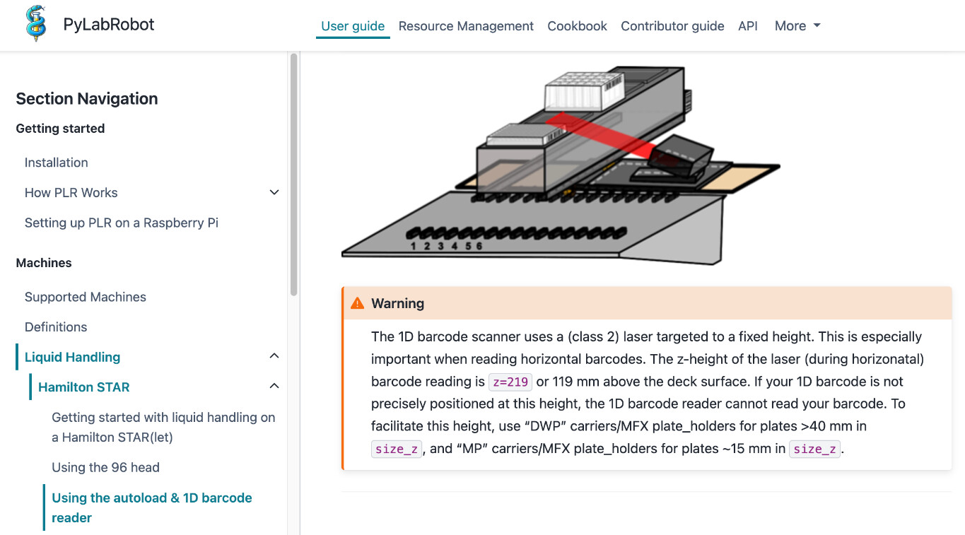

If you wanted to, yes, you could definitely to that now, and it wouldn’t take too much time if you follow all the rules of Hamilton STAR 1D barcode reading (e.g. barcode has to be at z=219mm, barcode symbology has to be supported, barcode has to be on the right side of a plate, 1D barcode has to be perfectly horizontal, …) :sweat_smile:

No - the magic number is 219mm (to my knowledge)

Ahh. That is unfortunate. What would you use the 1D barcode reader for? Just the carriers?
What if you just backed up the reader? The angle doesnt change and thus reading at a higher height… Not sure if the focus changes. This is my limited knowledge of how the reader works.
