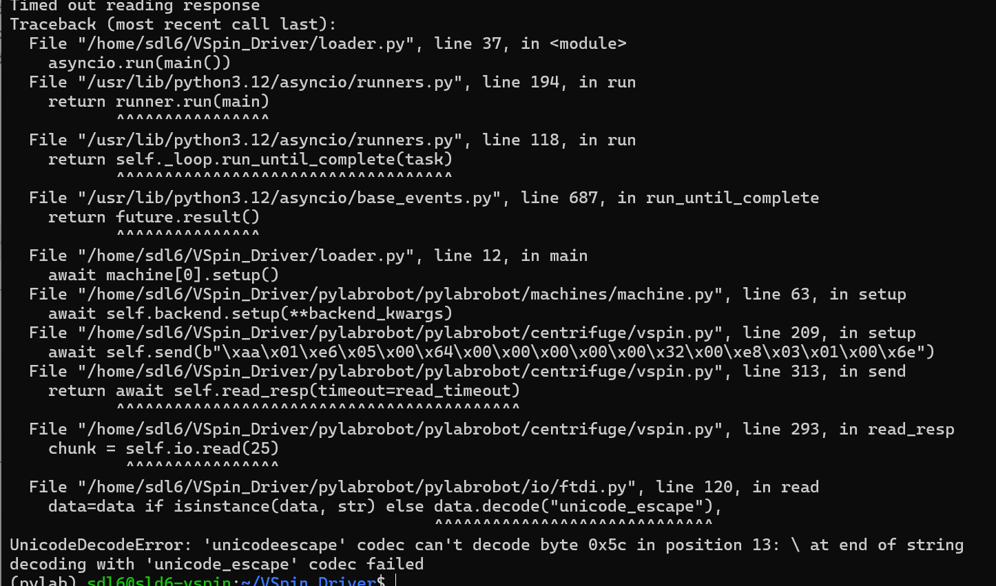

Intermittent bug on Centrifuge
This error will come time to time. Running the same script. Somtimes it works, sometimes this bug.
Thank you
hopefully fixed with fix ftdi io by rickwierenga · Pull Request #430 · PyLabRobot/pylabrobot · GitHub as discussed on github
