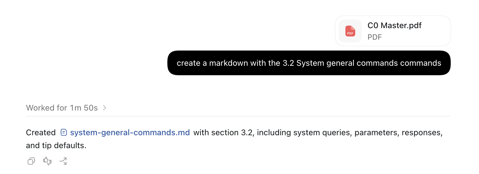

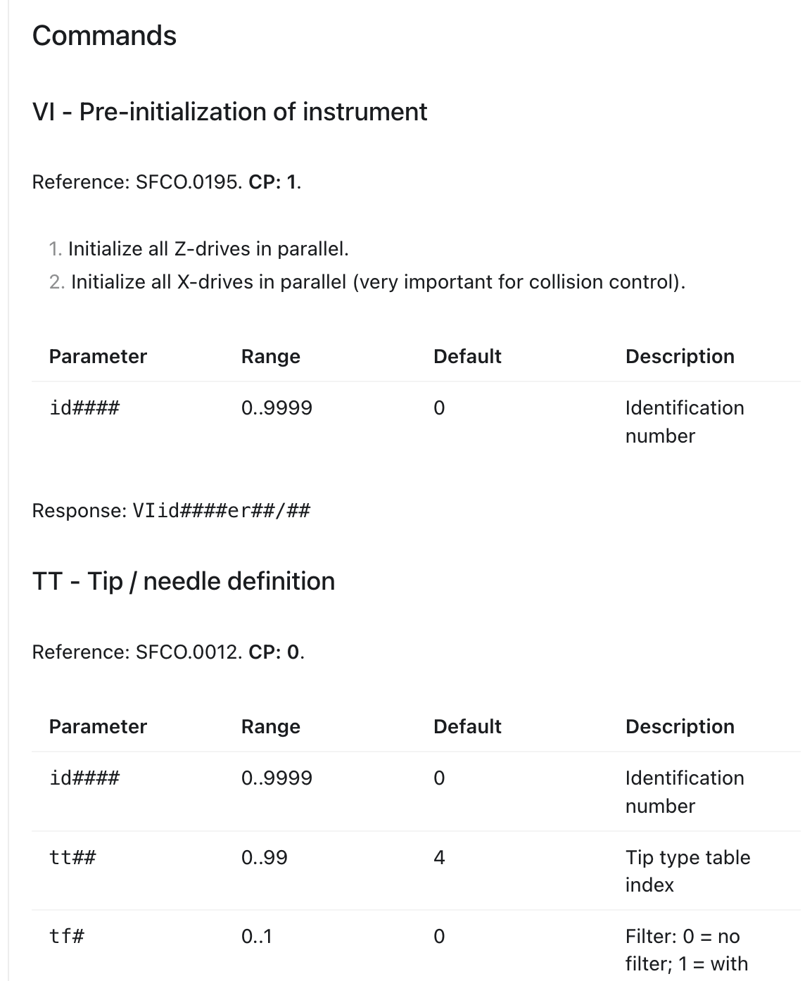

for hamilton specifically, we are already very complete so most of what I do is take individual snippets/pages and just paste a screenshot
for other documents, why not just ask codex to read the pdf on your computer? I havent experienced problems with it. astra is able to read it straight from the pdf and probably other models can do it too
also what would this skill do exactly? just information retrieval? that’s already solved
for sending robot commands, the firmware documents a specific layer of that stack but PLR is not just a python translation of it, you need more like resource positioning, command/response reading/sending and matching, knowing the order of commands to send, state, fixing the occasional bug in the fw docs, etc. essentially the reasons @CamilloMoschner is a busy person
