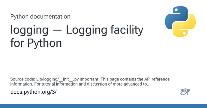

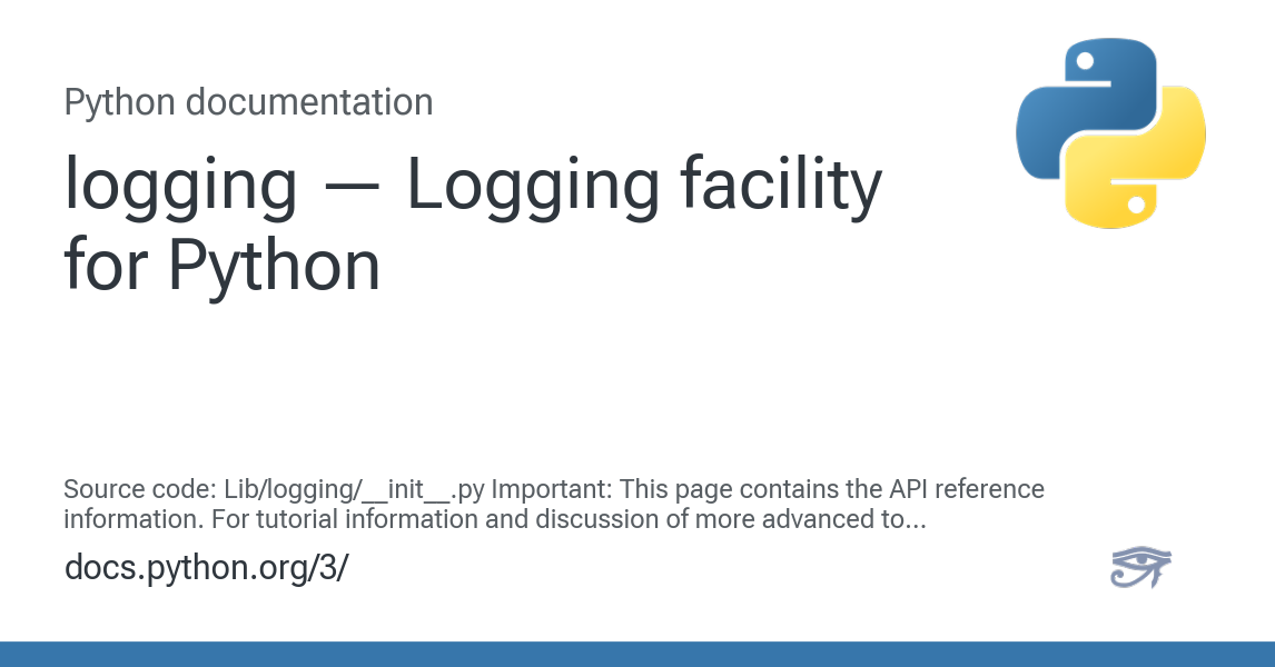

Do we have a list of log levels documented somewhere?
this is the only custom one in PLR
other than that we use the default ones
