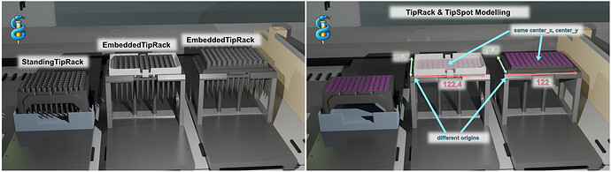

I donāt think modelling the TipSpot to refer to the bottom of the tip_rack holes is universally logical:
EmbeddedTipRacks the hole_size_z gives the tz/za location but for StandingTipRacks the hole_size_z does notTipSpot is a āspotā by name, i.e. a 2D object (?)If TipSpot were to be defined by the top of the hole opening it wouldā¦
dx, dy, and dz location relative to the tip rack itself,tz/za information andNote: I added a model for the hamilton_96_embeddedtiprack_raised (?) which Hamilton seems to call 96-Well Tip Adapter (even though a well, by definition, has a bottom and this tip rack has only holes) as an example of another Hamilton EmbeddedTipRack.

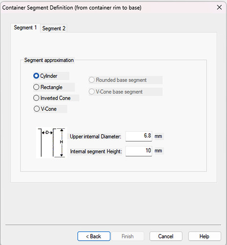

I checked out the labware definitions for the tips in Venus, and it turns out the collar height is defined as āsegment 1ā for the tip container definition (10mm for the 1000s (pic below), 8mm for the 300s and the 50s).
For what itās worth, Venus defines the tip z location by the distance from the bottom edge of the rack (the surface that rests on the tip carrier) to the end of the tip (they call this dimension ādistance from base of rack to outer base of all containersā, normally this would be the Z distance between a plate skirt and the bottom of a well).

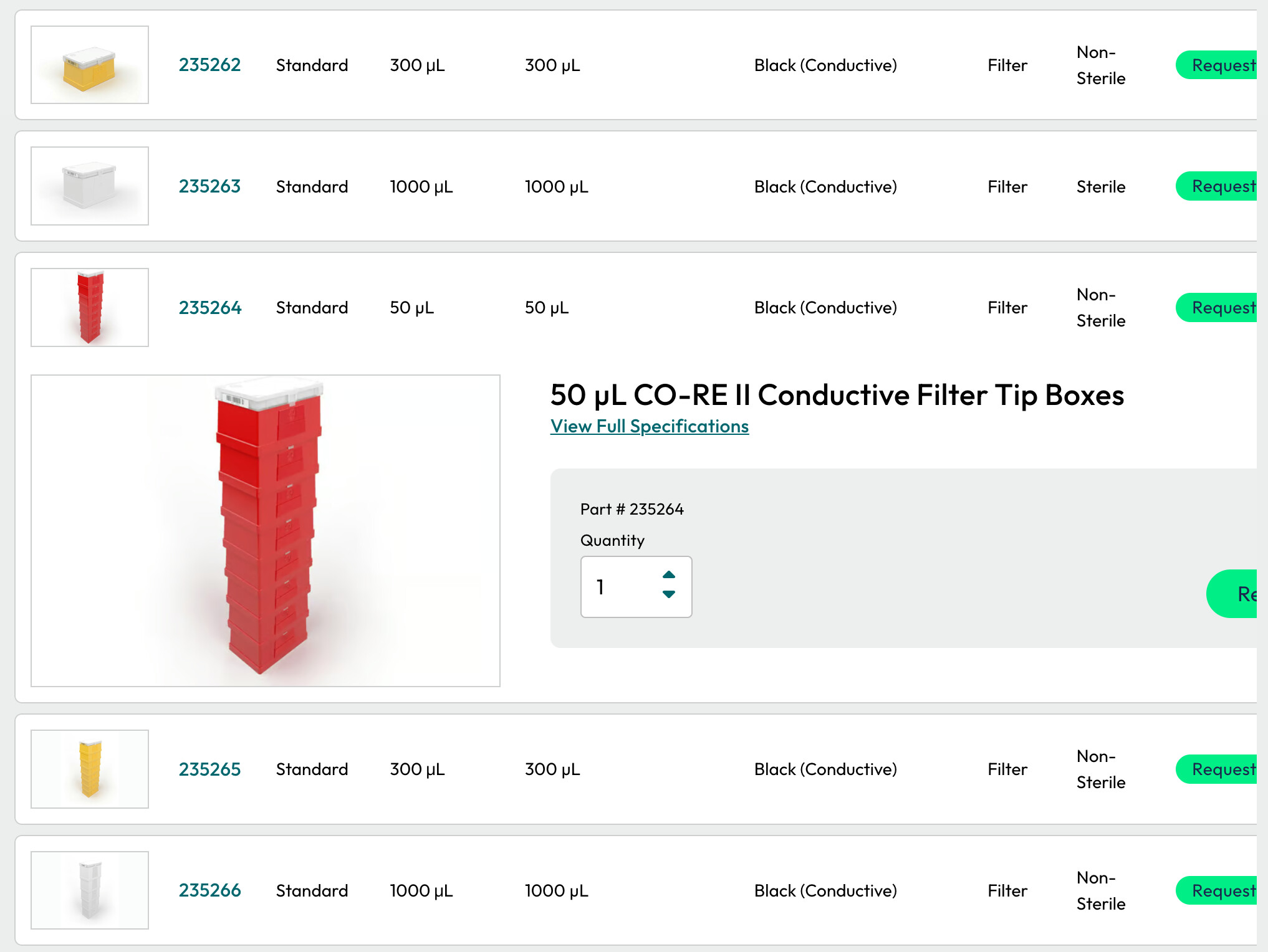

Iām curious if anyone has used nested tip racks in PLR yet? I see there is an NTR carrier definition in resources.

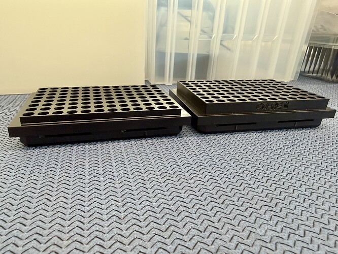

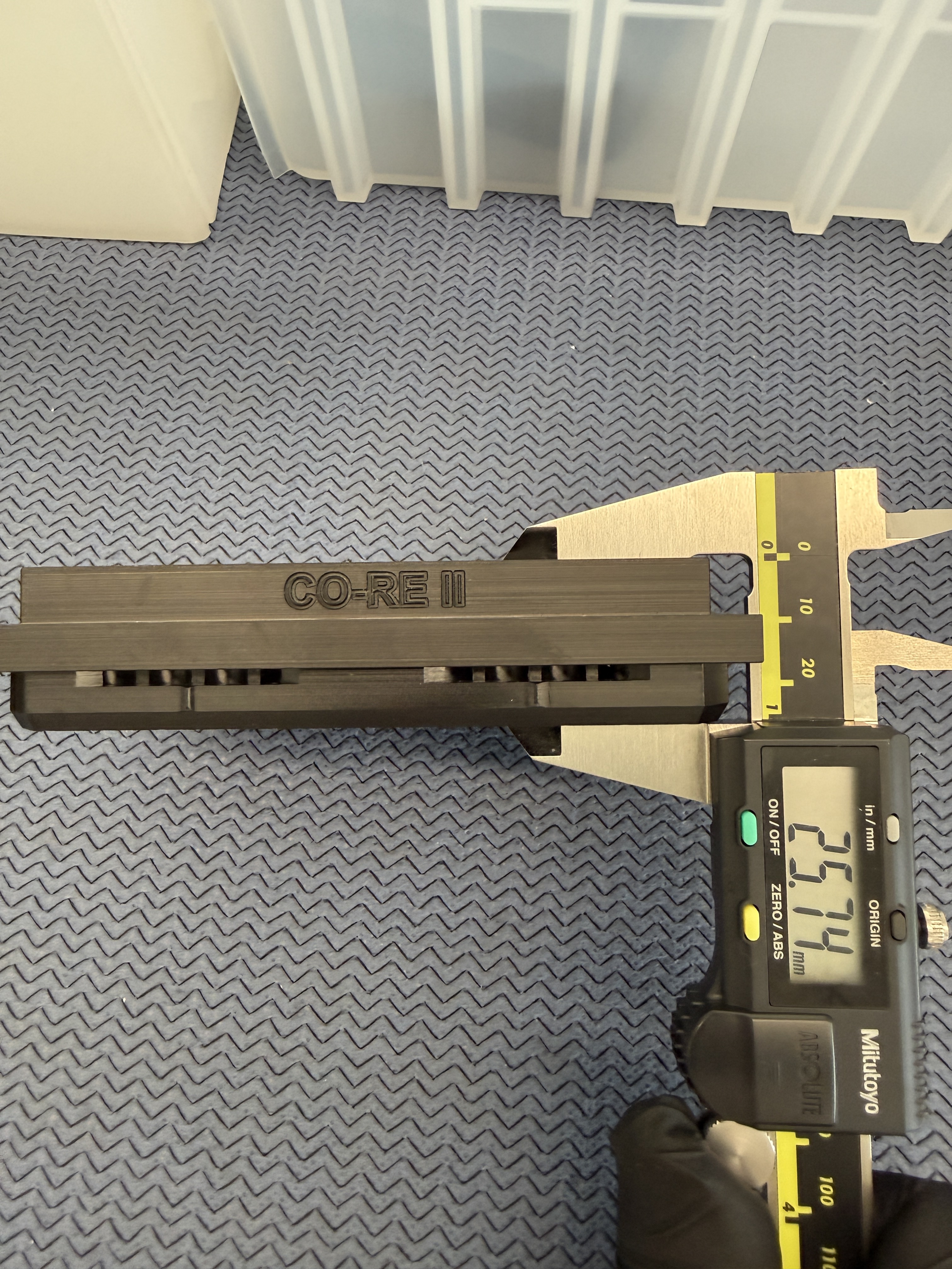

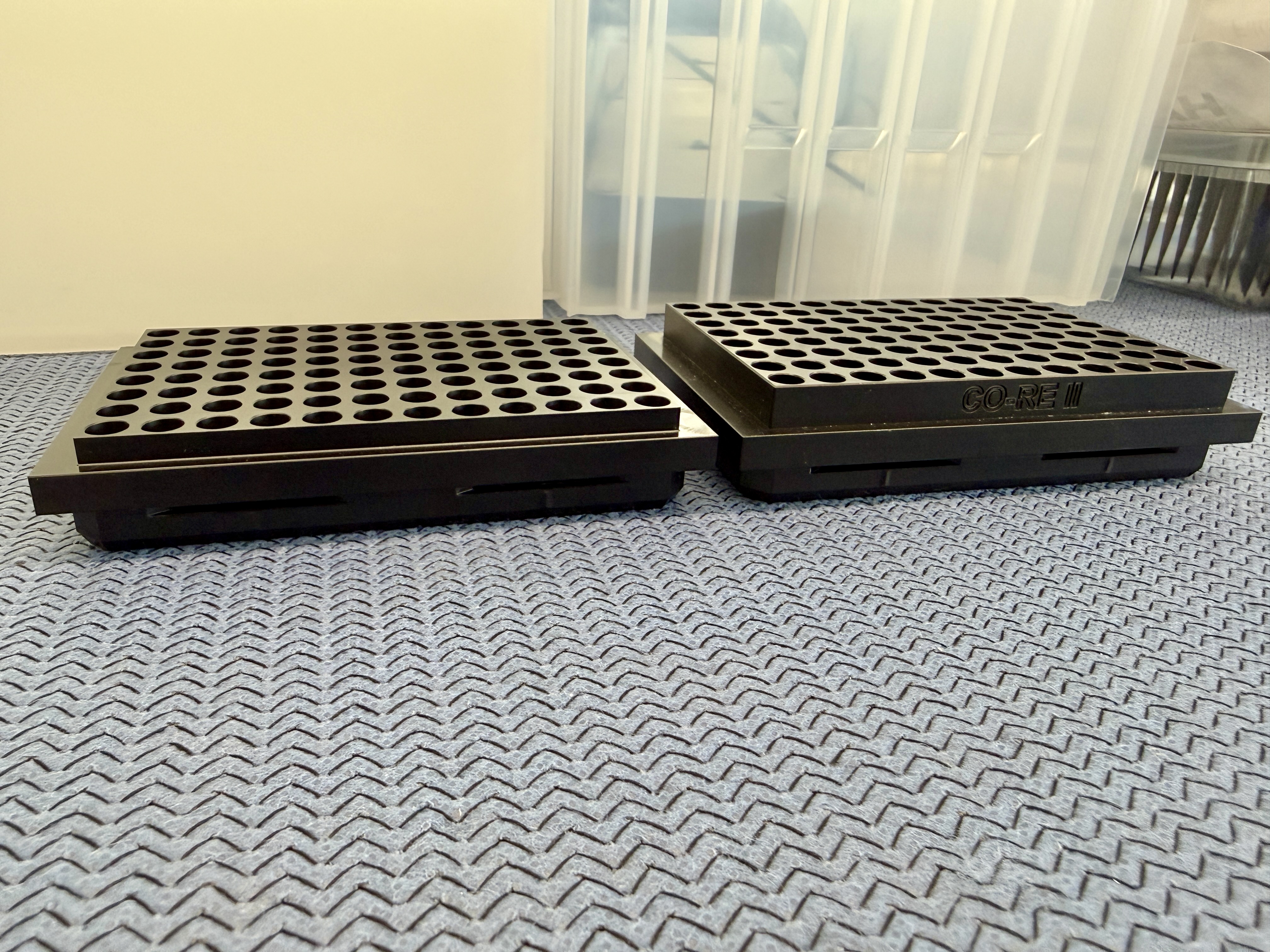

- There are two versions of the 96-well tip adapter: one for CORE 1 heads and one for CORE 2 heads ā they have slightly different geometry. It would make sense to specify which one youāre using to avoid confusion in the future (the CORE 2 one has āCORE 2ā engraved into it) Not sure if CORE 2 is supported in PLR yet? There is a firmware update for instruments that have the CORE 2 tip attachment mechanism.
are the sizes actually different? so far we have only been using one definition and it seems fine? if they are different we would need two definitions. the current definitions are definitely based on core-i (core-ii wasnāt released yet when I made themā¦)
Ya they are different ā the CORE 2 one is thicker. I believe this is because the CORE 2 mandrels/stop disks are longer (they seat more deeply into the tips), so the adapter needs to be taller to prevent them from hitting something next to it during an offset tip pickup.

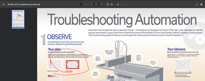

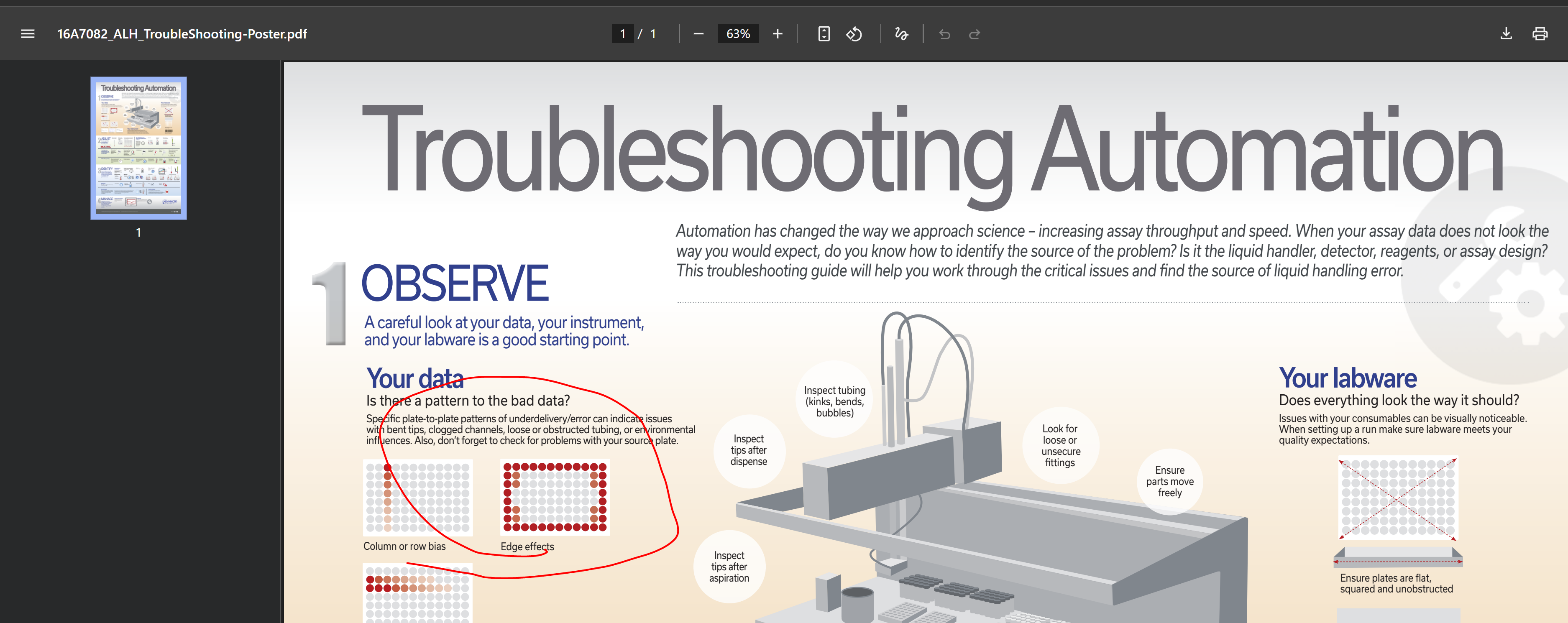

I canāt find it right now but Artel ran a study that showed the Hamilton 96heads have āedgeā effects when picking up tips. Hamilton added the two middle pins to the tip racks after that. Still if youāre looking for the highest precision dispense its best to pickup from theseā¦. we rarely do though. Just wanted to point this out that they arenāt just used for sorting. I did find this poster from artel, but I swear thereās a real study/poster. Might be off topic lol
and 6 mm for the 10 uL tips? ![]()
Yes, isnāt this why the TipRacks are āhardcodedā to a specific tip type in VENUS?
Absolutely - I have actually only ever used CO-RE II (which should rather be called āMetal Bearing Expansionā Technology imo because there is no O-Ring Expanding anywhere anymore [to my knowledge]
To my understanding, the firmware update actually takes care of all the updates?
At least I never had any (noticeable) issues with CO-RE II tips.
Thank you @adamferguson !!
This is some very important and actionable information. It makes a lot of sense to raise this embedded tip rack higher considering the longer āCO-RE IIā head bottoms!
But I did not know about it and you might have just saved my 96-head from an uncomfortable encounter with a tip carrier during the planned (but not yet PLR-possible) partial tiprack pickup ![]()
Iāll make sure to use the correct, taller hamilton_96_embeddedtiprack_raised_core2.
You mean that tips on the periphery might not beā¦
(1) picked up properly (e.g. the center of the tiprack bends downwards under the pressured of the 96-head and therefore the tips on the periphery would tilt inwards?), or
(2) might have incomplete sealing of the old expanded (black rubber) O-ring or new lowered (red rubber) O-ring, leading to air-creep into the piston and resulting failure of aspiration/dispensation accuracy?
And that a totally flat sturdy surface like the hamilton_96_embeddedtiprack_raised_core1/2 is the way to ensure this cannot happen?
(2) might have incomplete sealing of the old expanded (black rubber) O-ring or new lowered (red rubber) O-ring, leading to air-creep into the piston and resulting failure of aspiration/dispensation accuracy?And that a totally flat sturdy surface like the
hamilton_96_embeddedtiprack_raised_core1/2is the way to ensure this cannot happen?
It was 100% present with CORE1 and tip rack adapters that did not have the two metal pins. It was still somewhat present with the metal pin supports. I believe it was O-ring not sealing all the way as the middle of the rack bent so much⦠though this was discovered before my time and the two pin tip racks were already implemented. I swear thereās an artel poster for it but canāt find it anywhere. I believe it was very very small amount, but still no one was measuring heat maps of plates until artel and they found this error.
I have no idea if this is replicable with CORE2ā¦.
Itās more of the rigid surface.
Bowed decks tooā¦:Checking Dispensing Volume - #21 by DanielYip - liquid-handling - Lab Automation Forums
^ I wouldnāt be surprised if this was a missed diagnosis of the rack bending tbh

I generally agree that not all
StandingTipRacks have to be able to be nestable⦠but I cannot think of an immediate example that cannot - Opentrons ones can:
Opentrons racks stand by themselves, but the top part still looks like an EmbeddedTipRack to me, and the bottom could be a āTipHolderā as you call it. In that picture.
The Hamilton NTRs are clearly StandingTipRacks though.
This is an Opentrons specific question, I can get started with other work before making this decision.
- I am not aware of a use case for the explicit recording of the hole_size_z by itself (?)
we would still need to know the size z of the EmbeddedTipRack, and where the hole is wrt the EmbeddedTipRack lfb. While the hole does not necessarily āneedā a size, we would still be measuring this length of information if we defined TipSpots as āthe top surfaceā. Either the TipSpot will be at location z=Z or at location z=0 with size_z=Z.
In the case of StandingTipRack, I agree itās more difficult to measure and kind of pointless.
I am inclined to agree with you for this reason, making them flat surfaces makes sense so itās consistent between ETR and STR.
itās not just re-modeling, we actually need to figure out what the measurement of all of these things are.
in the labware editor (per @adamfergusonās suggestion) the tip sections are:
meanwhile the firmware commands (and thus PLR) defined these lengths as
I wonder why and where this comes from.

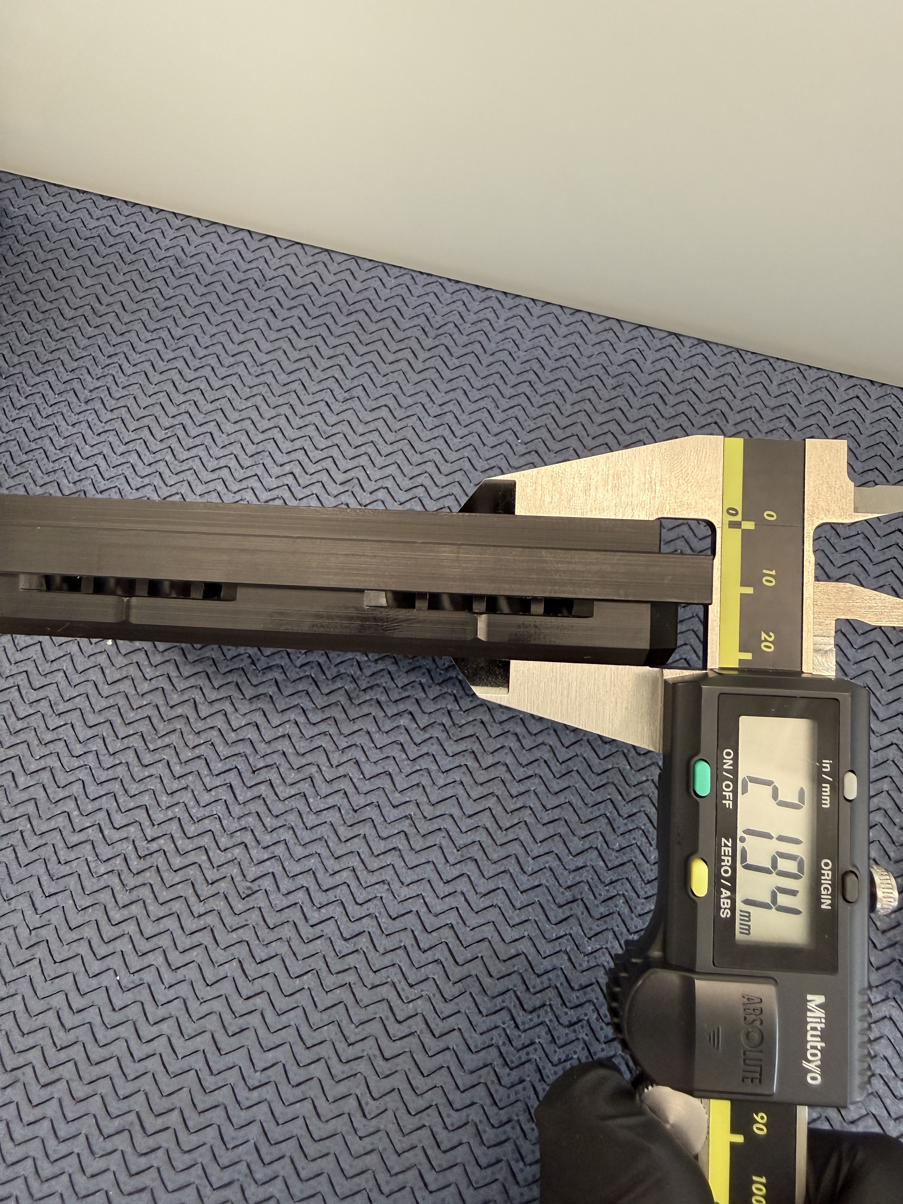

in my calipering the 10uL and 1000uL tips are 29.9mm and 95.0mm long.
the differences in collar height do explain this hack which has been in PLR since the beginning:
# not sure why this is necessary, but it is according to log files and experiments
if self._get_hamilton_tip([op.resource for op in ops]).tip_size == TipSize.LOW_VOLUME:
max_tip_length += 2
elif self._get_hamilton_tip([op.resource for op in ops]).tip_size != TipSize.STANDARD_VOLUME:
max_tip_length -= 2
(at first I was a trying to match the firmware command values based on what I saw venus generates + numbers I saw in venus [instead of thinking about physical reality], but at that time I didnt know about the labware editor.)
is anyone using NestedTipRack Create NestedTipRack Class by BioCam Ā· Pull Request #228 Ā· PyLabRobot/pylabrobot Ā· GitHub?
Yes I am - quite cumbersome atm though and very eager to build properly
