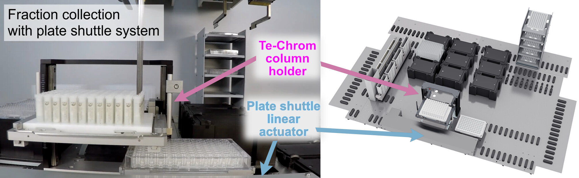

Tecan has been partnering with Atoll and now Repligen Corp on making the RoboColumns easier to use by developing a hardware + software supplement solution:
The adapter for the RoboColumn array and “Plate shuttle system” (i.e. linear actuator that moves an elution plate underneath the columns), is called "Te-Chrom, owned and only sold only by Tecan?
If true, does this mean one can simply purchase RoboColumns directly from its manufacturer, Repligen Corporation, and figure out how to use it on anything?

  1. Is the plate shuttle just to automatically move the elution plate underneath the columns?

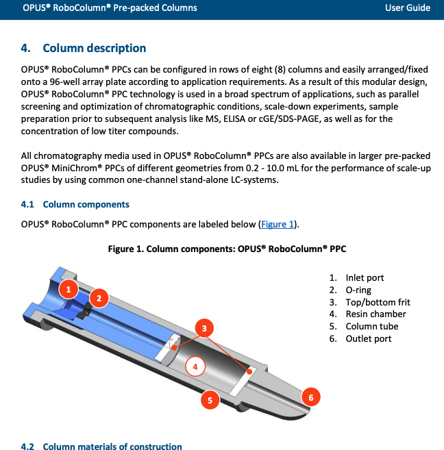

  2. Has anyone measured the O-ring size of the RoboColumns and the inlet port geometry, or even better, tested whether a Hamilton tip or needle fits into this??
It’s not the the columns its the Liquid FCA on the Tecan.
Liquid FCA
  • Liquid-Filled System:
Unlike air-displacement systems, the L-FCA uses a liquid-filled system as a wash fluid or diluent.
The liquid FCA acts as a continuous pressure column. It is acting as a chromatography column, using the system liquid as back pressure to push the samples through the column. Its a physical hardware limitation that Hamilton or any other manufactures have not met.
