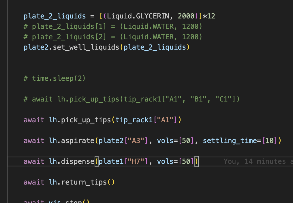

When trying to change the settling time I get this.
I have set the plate to Glycerin.
Please tell me if I’m missing something.

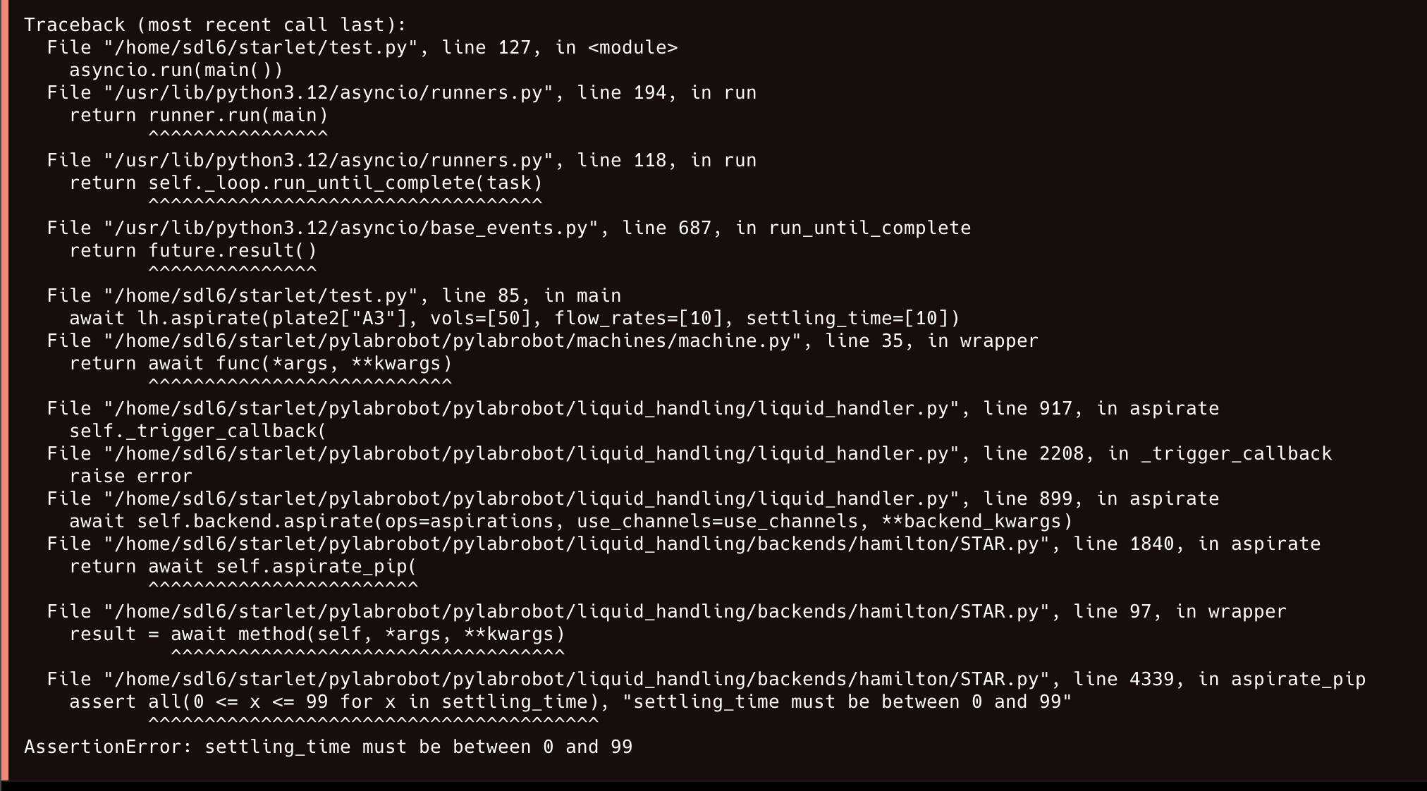

So the error only happens when you use the Liquids.GLYCERIN liquid class? For this liquid class the settling_time defaults to 2 seconds, which should actually pass the check which fails in your code, so it would be interesting what the settling_time actually is when the code is run.
Are you really working with pure Glycerin and not some mixture, like Glycerin 80%?
Just tried with None for liquid. Same issue. Pure Glycerin. Could it be something wrong with how I am passing it in? I do see that _fill_in_defaults cleans things us pretty well.
Can you inspect the values actually end up in the aspirate_pip method?
settling_time=10
settling_time=[10]
I tried both of the above in asiprate.
Both time this same result.
[100]
Is coming from print(settling_time) before all the assets in aspirate_pip in STAR.py
So it seems like on top level (LiquidHandler), the value is given in seconds? And 10s seems quite long, even for Glycerin. If such a long settling time is required, you probably are better of with a slower flowrate.

Code I tried:
    plate_2_liquids = [(Liquid.GLYCERIN, 2000)]*12
    plate2.set_well_liquids(plate_2_liquids)
    await lh.pick_up_tips(tip_rack1["A1"])
    await lh.aspirate(plate2["B3"], vols=[200], flow_rates=[5], settling_time=10)
and
await lh.aspirate(plate2["B3"], vols=[200], flow_rates=[5], settling_time=[10])

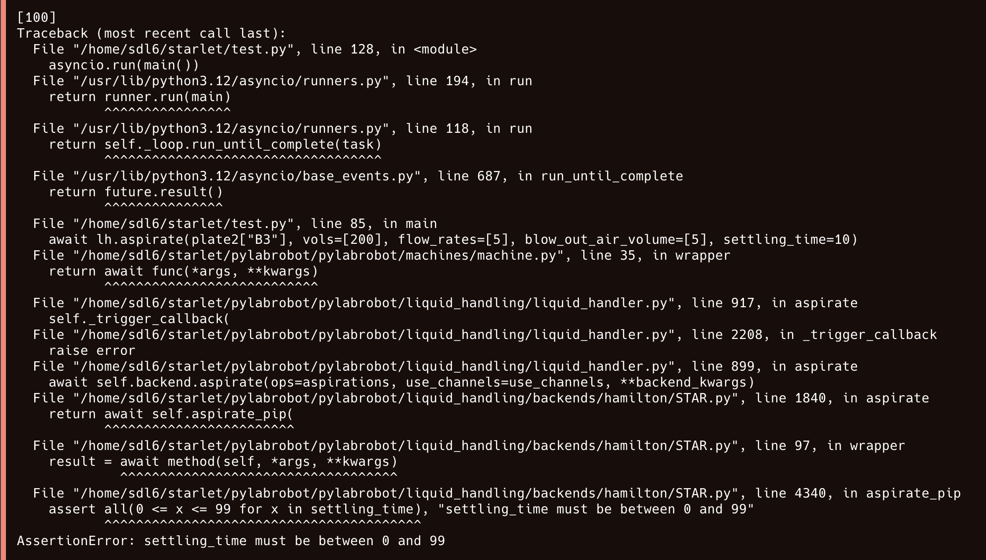

Error:
[100]
Traceback (most recent call last):
  File "/home/sdl6/starlet/test.py", line 128, in <module>
    asyncio.run(main())
  File "/usr/lib/python3.12/asyncio/runners.py", line 194, in run
    return runner.run(main)
  File "/usr/lib/python3.12/asyncio/runners.py", line 118, in run
    return self._loop.run_until_complete(task)
  File "/usr/lib/python3.12/asyncio/base_events.py", line 687, in run_until_complete
    return future.result()
  File "/home/sdl6/starlet/test.py", line 85, in main
    await lh.aspirate(plate2["B3"], vols=[200], flow_rates=[5], blow_out_air_volume=[5], settling_time=[10])
  File "/home/sdl6/starlet/pylabrobot/pylabrobot/machines/machine.py", line 35, in wrapper
    return await func(*args, **kwargs)
  File "/home/sdl6/starlet/pylabrobot/pylabrobot/liquid_handling/liquid_handler.py", line 917, in aspirate
    self._trigger_callback(
  File "/home/sdl6/starlet/pylabrobot/pylabrobot/liquid_handling/liquid_handler.py", line 2208, in _trigger_callback
    raise error
  File "/home/sdl6/starlet/pylabrobot/pylabrobot/liquid_handling/liquid_handler.py", line 899, in aspirate
    await self.backend.aspirate(ops=aspirations, use_channels=use_channels, **backend_kwargs)
  File "/home/sdl6/starlet/pylabrobot/pylabrobot/liquid_handling/backends/hamilton/STAR.py", line 1840, in aspirate
    return await self.aspirate_pip(
  File "/home/sdl6/starlet/pylabrobot/pylabrobot/liquid_handling/backends/hamilton/STAR.py", line 97, in wrapper
    result = await method(self, *args, **kwargs)
  File "/home/sdl6/starlet/pylabrobot/pylabrobot/liquid_handling/backends/hamilton/STAR.py", line 4340, in aspirate_pip
    assert all(0 <= x <= 99 for x in settling_time), "settling_time must be between 0 and 99"
AssertionError: settling_time must be between 0 and 99
The [100] is a print statement in pip_aspirate printing settling_time
Nevermind. It all just made sense to me.
If not mistaken then the max settling time would be 9.9?
So it should be:
await lh.aspirate(..., settling_time=[9.9])
Yes
