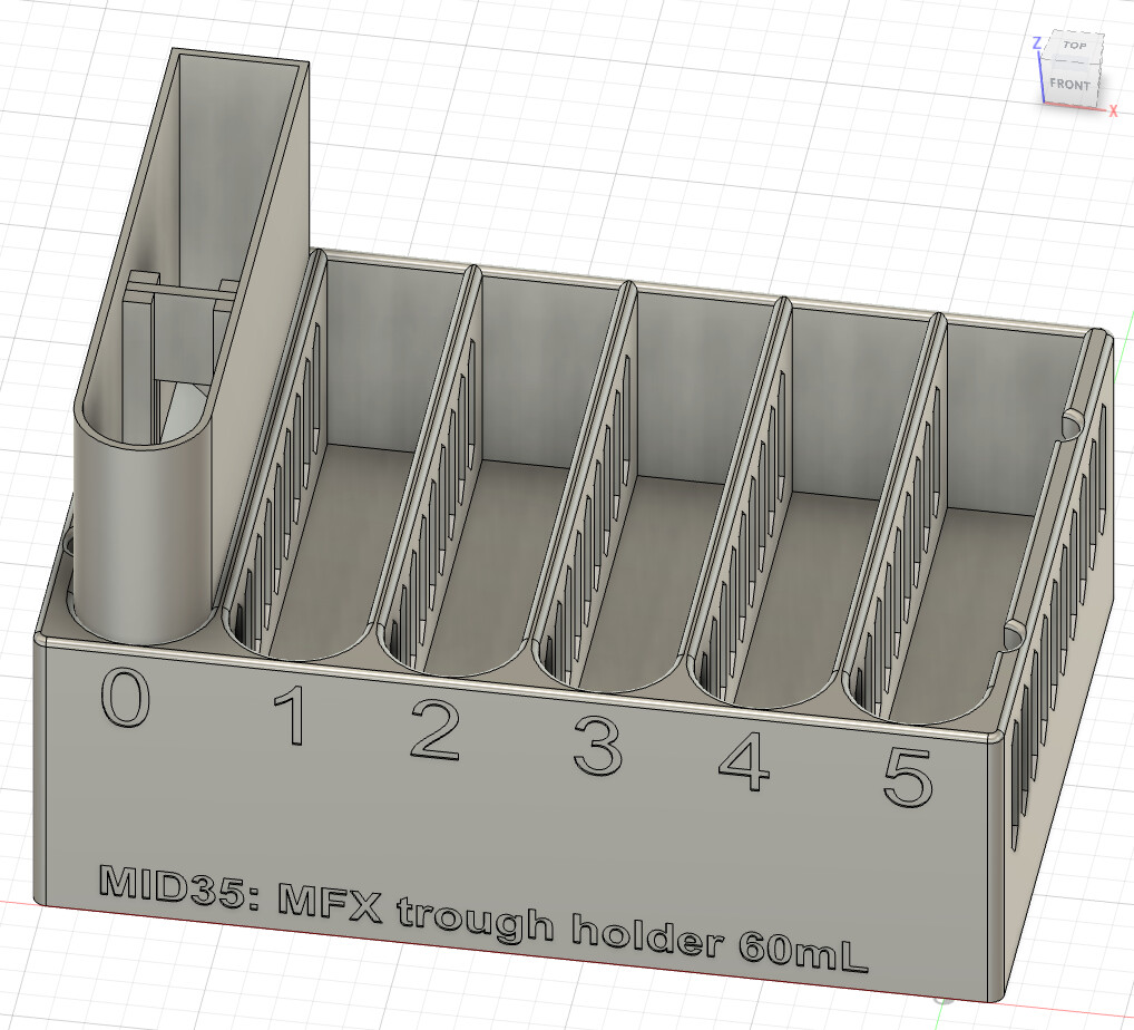

    • expand MFXCarrier accepted child resources, currently hard-coded to only accept a ResourceHolder but ResourceHolder accepts only 1 (!) child_location, i.e. it currently fails to accommodate for a “ResourceHolder” with multiple child_locationS. Example:
      → Solution 1: expand ResourceHolder definition to accept multiple child_locations? (that might be the quickest and simplest way to achieve all needed behaviour without having to create any new Resource subclasses)
      → Solution 2 / hack: model this resource a Carrier that is being assigned to a mfx_carrier’s site?
      (Note: definition of Rack vs ResourecHolder with multiple child_locations can become a bit messy, and maybe there should not be a Rack at all?)

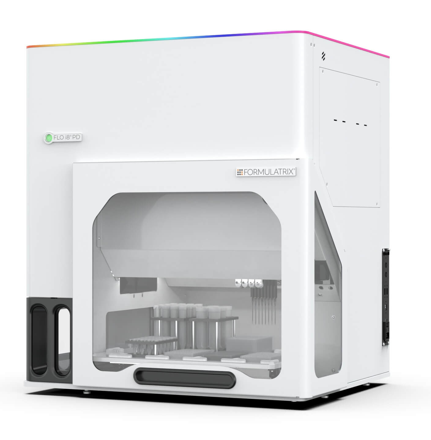

Would like to potentially float the idea of a Floi8 liquid handler in pylabrobot if you’re talking to manufactures:
These things were sick when we demo’d one but it was locked behind programming from a ultra basic drag and drop UI you’d find on a tablet… They made it ultra low code but packed in all the hardware features of a Hamilton and more.
If they unlocked this little guy it would be a beast. It’s got cLLD, side touch stress sensors, z-touch sensors, and camera integration. The cLLD tips can detect the height of the liquid in the tip by using the resistance of graphite strips on the sides of the tips.
awesome! thanks for the suggestion. I’ll keep an eye out
these days it’s still a little hard if no one in the community has a particular machine, but if someone were willing to sponsor it I’d be down! :smiley:

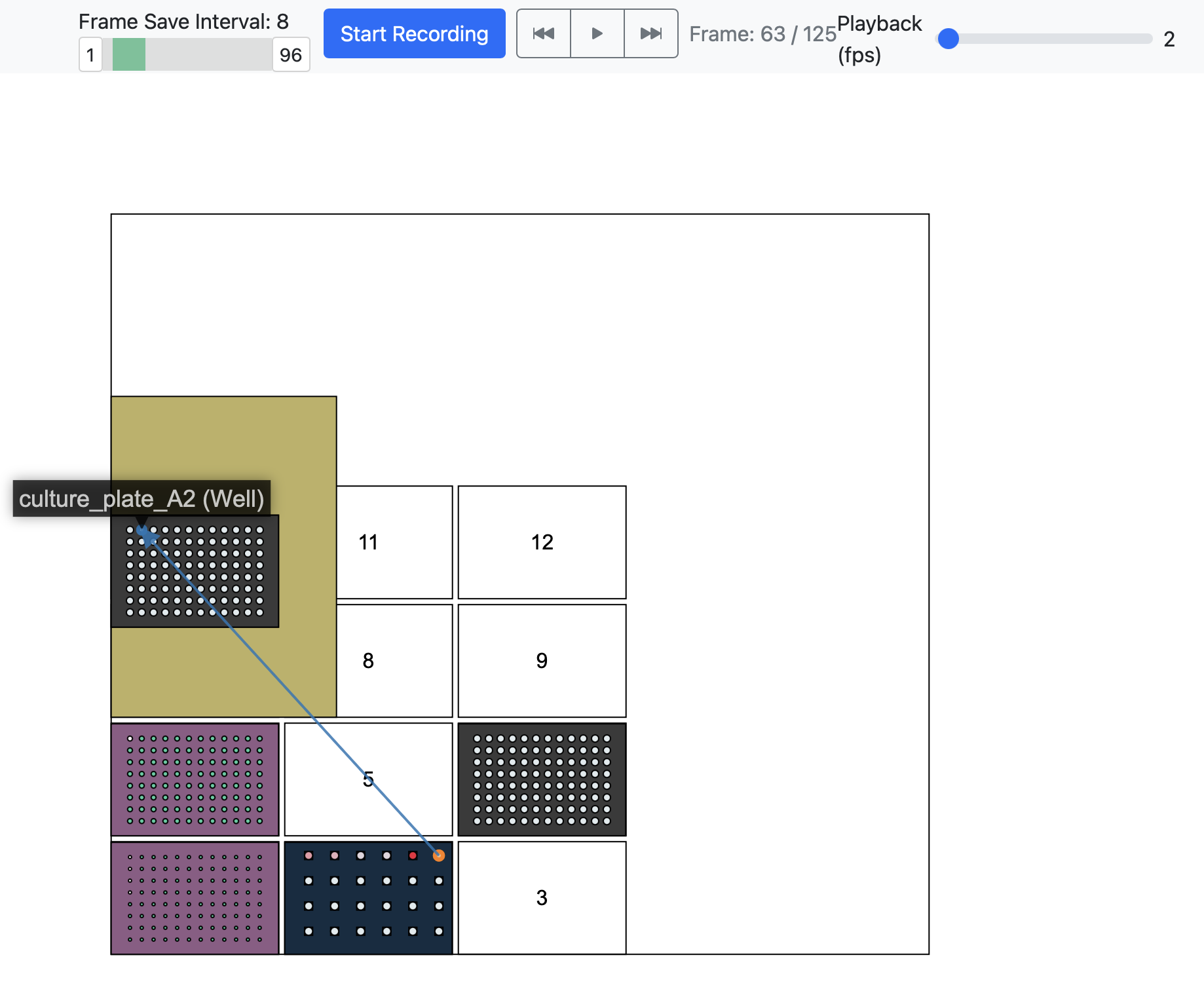

the visualizer currently just emit the live state of the resources to the browser, but i find this less helpful for simulation, as simulating usually finish execution in less than a second (in which opening the browser already showed the final state of the run). i’m thinking and trying to integrate new features in visualizer to:
  1. capture the state of each frames (state of the resources) at the server side then enable playback instead of the current live emitting→live monitoring only (if not mistaken what I have tried)
  2. enable better inspection by implementing manual click for next/previous frame, as well as FPS for simulation to slow frames shifting without needing to embed explicit delay in protocol
  3. enable pipette path motion, for aspirate-dispense, to better visualize liquid handling movements. i’m thinking of temporary motion path shown in between frame, mocking pipette moving, as currently it is hard to visualise the path from liquid tracking only.
however, this would need me to change quite much of the visualizer middle processing. i love the Konva visualization and gif implementation, which helps for actual hardware run. but, i find that the visualizer can act better during simulation and inspection before hardware run, even better than the chatterbox. what do you guys think?
concept:
this is exactly the point of the visualizer :grinning_face_with_smiling_eyes:
the goal is visualization not simulation. simulation means virtually mirroring/predicting the state of the lab
my view on simulation is we should always be simulating because it helps us have smart features (like return_tips) and prevent errors. this should always happen behind the scenes. no separate simulator should be required.
hm this is interesting. being able to click forward and backward through the states like a debugger :thinking:
to clarify, the visualizer and chatterbox are different concepts for different purposes. they are entirely independent.
  • chatterbox: a “fake” backend to debug protocols (for humans and ai agents). it accepts all commands and just prints out what is happening. the machine-agnostic tutorials in the user guide use this
  • visualizer: shows the current model PLR has of the lab. it can be used when you are using the chatterbox, or any other backend. with chatterbox you don’t have to have a robot so you can develop in-silico, with a real backend you can make sure PLR’s model of the deck is what you see in front of you. (the architecture is set up so you can visualize any resource subtree, including just plates when you are calibrating them)
LiquidHandler and the resource model are responsible for most of the “simulation”, and neither the chatterbox nor the visualizer simulates anything - they are just passive objects.
I agree the visualizer is very useful for inspection, and the chatterbox is useful for developing protocols when not connected to a machine.
overall: 1) the goal of the visualizer is not simulation, 2) I really like your idea of being able to time travel through the states in the visualizer. I will work on implementing this
this is largely done by firmware on all machines, so simulating it (anywhere in PLR - separate from visualization) will be a pain
