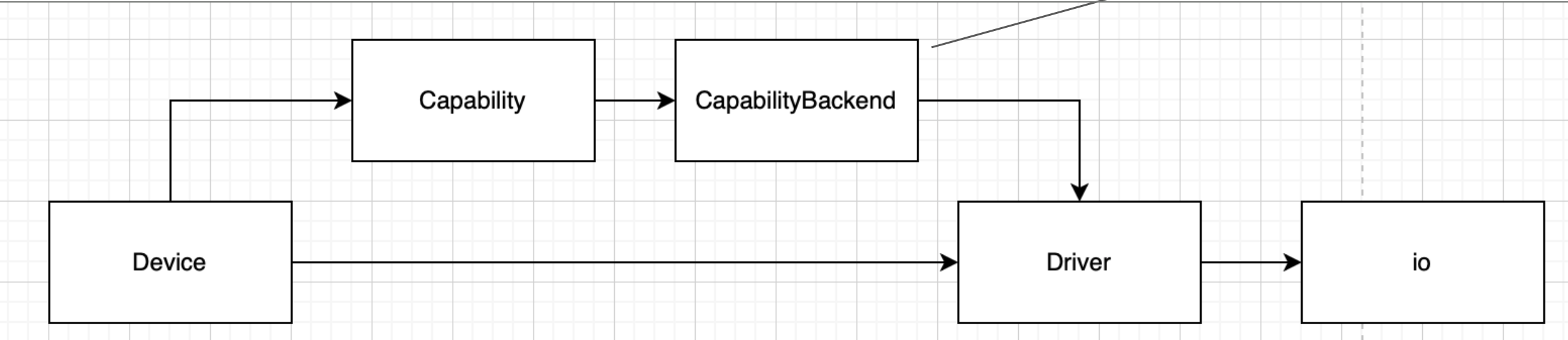

Each capability has a backend. When a Device might have multiple capability backends, they need to share a machine connection, send_command etc. This creates a new concept called the Driver, which provides the shared connection as well as backend methods that do not cleanly fit into a capability backend. I imagine we will put methods like request_iswap_version in the iswap capability backend, even if the backend ABC does not require such a method. General methods like request_machine_configuration will live on Driver.
In diagram:
For complex machines, splitting into capabilities and backends is a natural way of splitting the 10k line god classes and god files.
